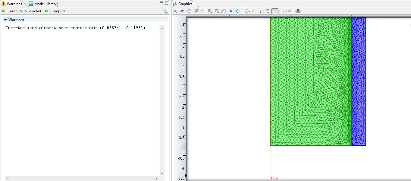

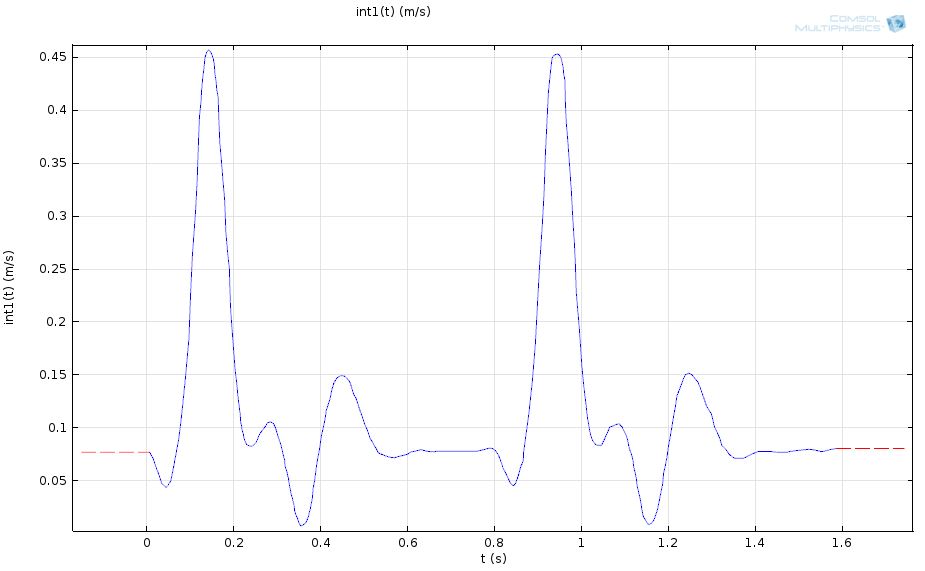

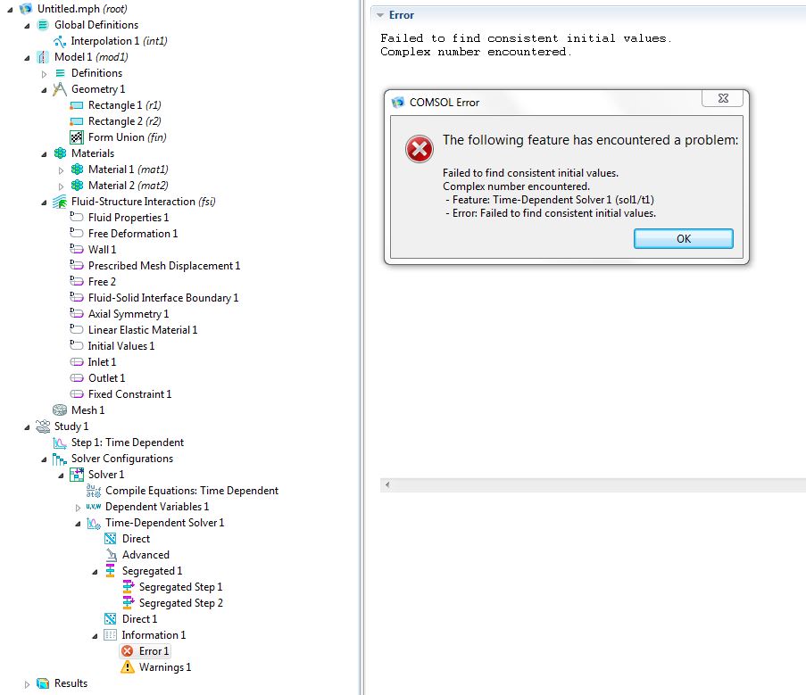

I'm trying to simulate pulsatile blood flow in an cylindrical elastic artery. I'm using a 2D axi-symmetric FSI model, and an interpolation function for the inlet profile, which looks like the CarotidArteryProfile.jpg that I've attached. I did a simulation using just the unsteady laminar module using this inlet profile, and it worked great. However, when I try the FSI module, I am getting the error shown in Error.jpg which I've also attached. The error pops up almost immediately. I also receive a warning about my mesh which can be seen in Warning.jpg. Does anyone have any suggestions? Thanks in advance.

I have two suggestions. The first one is to check the velocity in initial settings. It is set to 0 by default in FSI interface. Your initial value for the velocity at the inlet boundary seems around 0.075 [m/s] in CarotidArteryProfile.JPG. This discrepancy luckily works for fluid flow only but I doubt this still works for FSI. The other suggestion is to use ‘strict’ time stepping. Inside COMSOL, default time stepping is ‘free’, which is not always good for time-varying boundary conditions. Hope this helps.
Myungwu
Hi, I have two suggestions. The first one is to check the velocity in initial settings. It is set to 0 by default in FSI interface. Your initial value for the velocity at the inlet boundary seems around 0.075 [m/s] in CarotidArteryProfile.JPG. This discrepancy luckily works for fluid flow only but I doubt this still works for FSI. The other suggestion is to use ‘strict’ time stepping. Inside COMSOL, default time stepping is ‘free’, which is not always good for time-varying boundary conditions. Hope this helps. Regards, Myungwu
